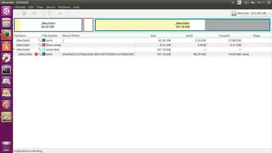

I was resizing the partition (enlarging) with gparted when about 2 minutes in there was a power cut. Now it won’t boot up and the filesystem is unaccessable.
I can see the partition in gparted but on attempting to do anything it gets stuck on “checking file system”.
gparted

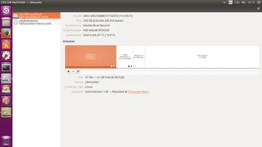

“Disks” doesn’t even recognise the file system - it just shows free space where the file system should be.
disks

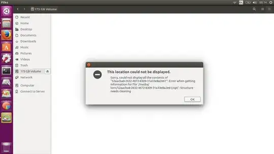

When I click on the “173GB volume” in the launcher, it says “…structure needs cleaning”.
