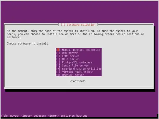

The installation image for ubuntu server is about 800M, and it has fairly minimal installation options:
With ubuntu server 16.04 if you choose only openssh and standard system utilities the resulting system takes about 1.4Gb of space.
You can then try setting up a VM with a minimal installation of the same ubuntu version that your "custom ubuntu" is using. Then and export the list of all the installed packages of this VM, and compare with those of your target system using the command dpkg --get-selections.
You will then be able to identify packages that are not essential (you will need to be careful about not removing the custom drivers that you are trying so hard to preserve).
