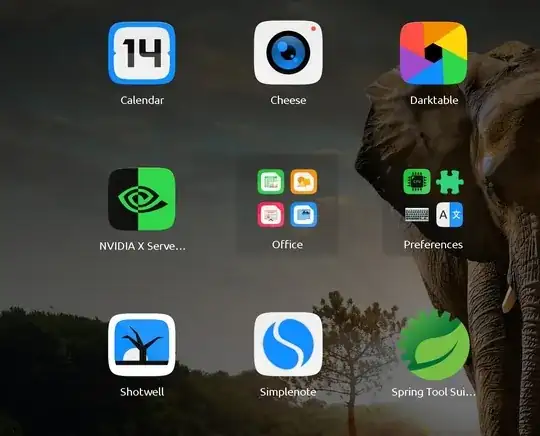

For Ubuntu 20.04 I did below and worked.
I did it for SpringToolSuite4.
Run the below command in terminal:
sudo gedit /usr/share/applications/STS.desktop
Above should open gedit. Paste below in the file and save:
#!/usr/bin/env xdg-open
[Desktop Entry]
Name=Spring Tool Suite 4
Type=Application
Terminal=false
Comment=Spring Tool Suite 4
Exec=/Path_To_STS/SpringToolSuite4
Icon=/Path_To_STS/icon.xpm
Categories=Development;IDE;Java;
Immediately after that, I see the icon in my Applications section:
