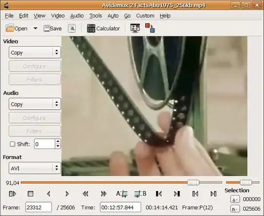

Avidemux is the closest thing Ubuntu has in terms of a simple video-editor/muxer. For more full blown non-linear editing tasks there is also kdenlive and Cinelerra.
Avidemux Screenshot
