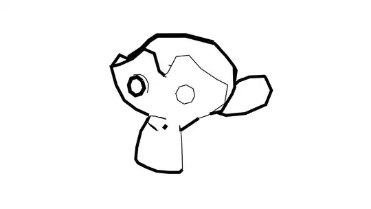

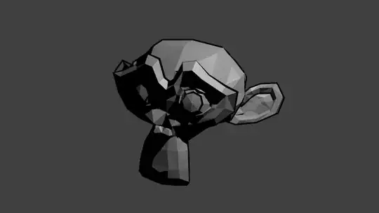

Within Freestyle there exists a plugin, SVGWriter, that can write Blender scenes to SVGs. Instructions for usage are available on that page. Below is an example of its output:
Original Blender render: enter image description here
Freestyle SVG output: enter image description here
Freestyle is still in development and you can follow its progress on their blog.

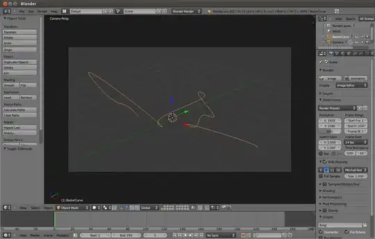

Finally, in Blender, draw your bezier curve and then go to File > Export > SVG. Here's an example of the output
Original Blender curve enter image description here
SVG output. The line thickness was increased for clarity enter image description here
