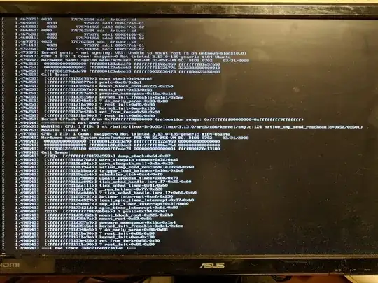

This is where the system crashes:
Crash Screen
I am hoping for help recovering at least enough to copy the files off the system.

  • I tried using the Advanced Options for Ubuntu to pick an older kernel and as far as I can tell this does not seem like it will work. I tried 20 or so older ones till I found one that would give me a different boot crash point but it still crashes. I can upload a screenshot if needed.
  • Second I looked at Kernel Panic - not syncing: VFS: Unable to mount root fs on unknown-block(0,0) This is giving me more questions then answers.
