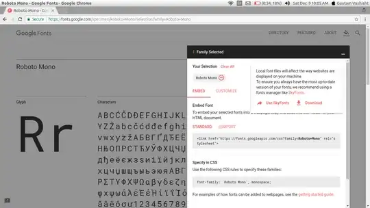

Go to this link and click on SELECT THIS FONT. Then a dialog box appears from bottom of the page. Click on that dialog box and then hover on Download icon in the top-right corner of that dialog box. It will open a small dialog box in which you get the following options(links) :-
Use SkyFonts and Download

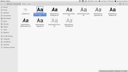

Click on Download option. It downloads a file named Roboto_Mono.zip. Go to your Downloads folder and extract that zip file. It will create a folder named Roboto_Mono. Open this folder. Inside it, you will find different .ttf files.
Click on each of them(one-by-one) to open it in Font Viewer and then click on Install button in the top-right corner.
Following this procedure, you will have Roboto Mono installed on your Ubuntu system.
