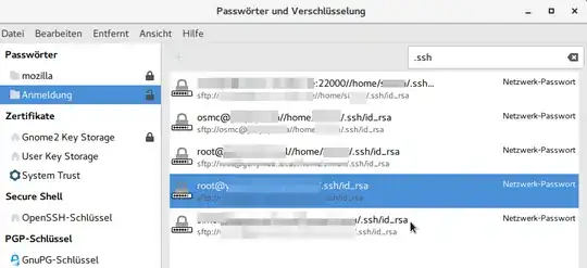

My second guess was, that for some reason I have to delete all related passwords stored in seahorse under »Passwords->login«: enter image description here
I was hoping to force the client to ask me again and then storing them again. But this didn't help either. The client does not pop up to ask me...
