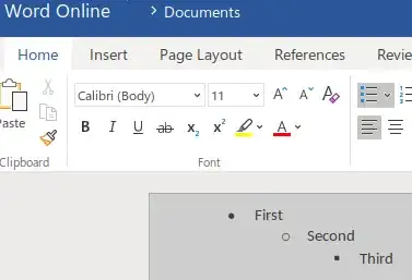

I'm using Word Online in Ubuntu and the bullet points don't appear correctly. This is what it looks like in Firefox:
How can I fix this?

  2. Once that's done, the bullet points should be fixed:
