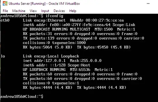

I am making a cloud server and am following this video tutorial. Everything went FUBAR when I used the ifconfig command in the terminal and did not receive the IP of my server. I have also tried ifconfig -a with no success. I require the IP address to move on to the next step.
I typed exactly, ifconfig:
screen capture

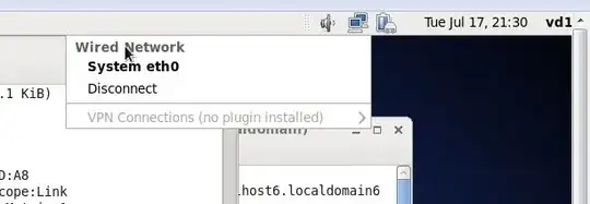

The reason why the inetaddr is missing could be that you're not connected to the internet.
As was in my case, if your Linux is hosted in a VM, ensure you have enabled networking.
