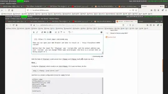

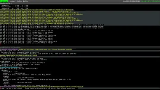

screenshot of running ffserver and ffmpeg command
Then you can open your Web Browser and watch the result at : http://localhost:8090/screen
Notice that the input for ffserver was /screen.ffm and the output address was just /screen you can change those names accordingly. And here is a screenshot of where it is being played on my local machine:
