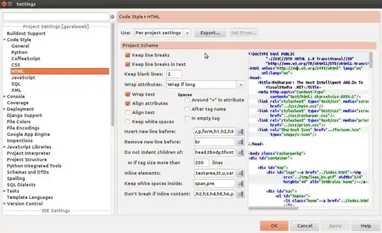

Not free, not command-line, likely too complicated, but IntelliJ Idea is an IDE that is able to do this. I haven't tested it with java or ruby, but it works quite nice with a django project (python + javascript + HTML).
It also has a quite extensive array of options to configure what to reformat.
If this is a one-time issue you can download a trial for free.
This a screen-shot of the HTML format options. It's taken from PyCharm (the python limited version, no ruby or java support here) as it's what I use, but IntelliJ should be the same but supporting much more languages.
