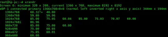

xrandr
xrandr output
Note the display device name from the output.In my case its eDP-1.
next run the following command
cvt 1920 1080
command output in terminal
Copy the whole Modeline from the output.
In my case it is as follows
"1920x1080_60.00"  173.00  1920 2048 2248 2576  1080 1083 1088 1120 -hsync +vsync.

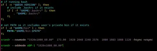

IMPORTANT: To make Ubuntu remember the new created screen resolution at next start, you have to edit your .profile. Use any text editor, for example:
vim ~/.profile
add the last 2 commands to the end
profile in vim
Save and reboot. Hopefully the system will detect 1920x1080 resolution in both your displays.
