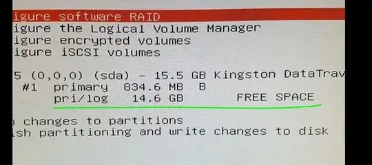

I have downloaded x32 version first from http://releases.ubuntu.com/16.04/. Used https://rufus.akeo.ie/ to create a bootable USB flash - selected DD, since there were problems with ISO and cdrom not found. The partition then look like:
During the partition step of the installation I was prompted with:
Which allowed me to select 14GB unlocated space and the system was installed into it and installation went fine and everything was great!
