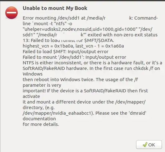

I am trying to mount a USB harddrive with NTFS. Ubuntu displays this eror message:
sudo fixntfs didn't resolve the problem.

How can I fix the volume from Ubuntu?
ntfsfix can only do basic NTFS repair tasks. It's main functionality is marking the file system dirty so that Windows will automatically scan it.
