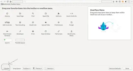

Just click the top-right menu (the hamburger(☰) menu) > Customize, you’ll be at the Customize Firefox page, on the bottom-left most, unchecked the Title Bar.
That’s it :)
See here
