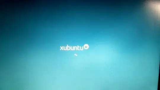

I have dual booted my desktop. It has Windows 8.1 and Xubuntu 16.04.3 LTS. When I select Xubuntu from GRUB menu, it takes to long to boot into Xubuntu. The screen stays like this for a long time.
Xubuntu boot screen
On presssing Escape from the keyboard, I observe a blank black screen.
After some time, Xubuntu finally boots up.
