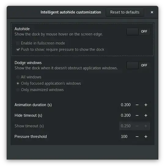

With this extension, you will be able to hide the dock but keep the dock-specific shortcuts available. To do that, enable the extension, go into its settings and do the following:
  • Enable the Intelligent autohide option under the Position and size tab.
  • Click on the "Gear" (⚙) icon next to the On/Off switch of the Intelligent autohide option for more settings.
  • In the new dialog window, disable both options, Autohide and Dodge Windows.
    Disabled Dock
    • Disabling autohide will keep the dock hidden even if you try to move your mouse to where the dock is.
    • Disabling Dodge windows will keep the dock hidden even when it is not obstructed by any window.
As mentioned previously, this will not uninstall or disable the dock. But it will completely hide it. So it will not show on screen again unless at least one of the two previous options is enabled again.

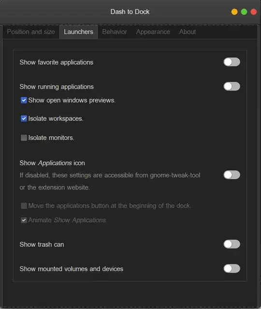

You can use the extension hide the Dock to hide the dock:
https://extensions.gnome.org/extension/307/dash-to-dock/
Enable the dash to dock extension and open the settings of dash to dock.
For parital hide:
  • Enable the intelligent autohide and click on the settings.
  • Disable the autohide. It will keep the dock hidden when the mouse is hovered over the dock.
To Hide it completely:
In the above step dock will be hidden but it will be visible on activites overview. If want to see the dock at all follow the below steps.
  • Go to the Launchers tab of the dash to dock setting.
  • Turn off everying you could find there because the list varies with versions.
  • Now dock have no icons to show so it will stay hidden.

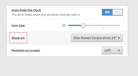

I had a slightly different need. I wanted the dock keyboard bindings but felt that the dock took up too much space. And the “hide” feature still showed the dock when I was using hotkeys to switch between them.
Removing the dock with sudo apt remove gnome-shell-extension-ubuntu-dock also removed the dock keybinds, it seemed.
What was an okay solution for my setup was to move the dock to the secondary monitor.
Dock settings
