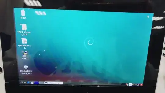

I'm using Ubuntu 16.04 with LXDE desktop:
Desktop
I'm trying to change the language to German, but I'm not sure how.

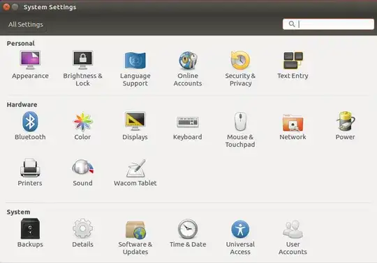

There is no need for terminal to do this, open the 'System Settings' (This is for Unity desktop, for LXDE it is called 'Preferences') application which opens the following window:

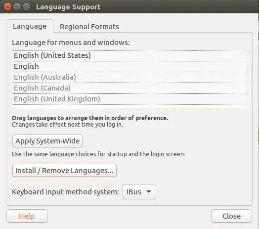

Then click on 'Language Support' and you get another window opening and maybe as well get a reminder that the language support is not installed completely.

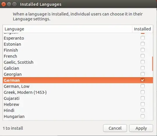

If that happens click on install which will then prompt you for your password and installs the missing language bits. You will end up in this following window where you can click on 'Install/Remove Languages' button and choose German.

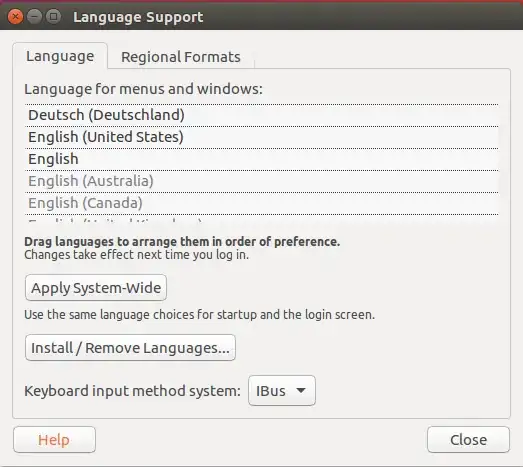

Click on 'Apply' to install German for the system. Afterwards click on 'Deutsch (Deutschland)' and move it up in the list to the top. Then click on 'Deutsch (Deutschland)' followed by 'Apply System-Wide'. you will then be prompted for your password again to make it happen.

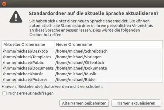

After this you will get greeted by the following window on your first log in where you can choose to keep the old folder names in your home folder or to actualize them to German as well.
Both options will work, and its up to you to decide what you want there.
