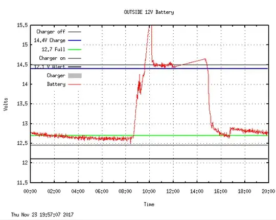

They then produce plots which are displayed as live plots on monitors up-to-the-minute. The gnuplot programs are very simple:
set title "OUTSIDE 12V Battery"
set xlabel "Time"
set ylabel "Volts"
set yrange [11.5:15.5]
set grid
unset mouse
unset log
set key top left
set timestamp
set xdata time
set timefmt '%H:%M:%S'
set xtics format '%H:%M'
set style fill solid 1.0
set terminal x11
plot  15.5 lw 2 lc rgb 'navy' notitle, \
      14.5 lw 1 lc rgb 'black' t "Charger off", \
      14.4 lw 2 lc rgb 'blue' t "14.4V Charge", \
      12.7 lw 2 lc rgb 'green' t "12.7 Full", \
      12.45 lw 1 lc rgb 'black' t "Charger on", \
      12.1 lw 2 lc rgb 'black' t "12.1 V Alert", \
      "today.dat" using 2:15 skip 2 with boxes lw 1 lc rgb 'gray' t "Charger", \
      "today.dat" using 2:8 skip 2 with lines lw 1 lc rgb 'red' t "Battery"
pause 15
reread
Note that the reread command in gnuplot causes the plot to update so they are displayed in real time on the screen when the logging system is accessed by Windows RDP via WiFi.
