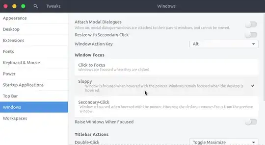

You may use (GNOME) Tweaks to achieve your goal. If it's not installed, first install it by running
sudo apt install gnome-tweaks
Launch Tweaks and go to the Windows section. Select "Sloppy" or "Secondary-Click" under Window Focus.
Alternatively you may run the following command
gsettings set org.gnome.desktop.wm.preferences focus-mode 'sloppy'
