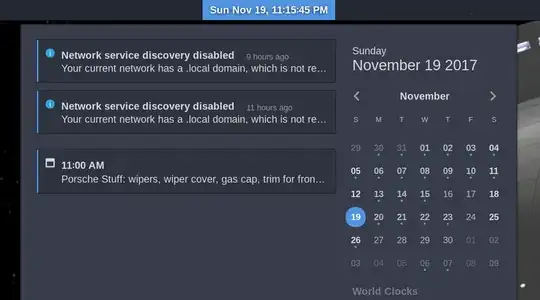

The Gnome Notifications area only shows the title and a portion of the first line of a message.
Clicking on the message in the Notifications area simply removes the message. I've tried looking at the Logs, but do not see the message there.
How can I view the full message?
In the screen shot below, there is a message about network discovery, but I can't see the rest of the message.

If what you are looking is to see the full message somewhere, the GNOME extension "Notifications to file" allows you to store the notifications to a file of choice.
Expert mode
If you are looking to see the full message in the notification list of your screenshot, you may want to change the CSS of that specific section of GNOME. There are some tutorials that help to do this, but I do not recommend to go this route unless you know what you are doing. You can see the documentation on Gnome Shell wiki page.
You can find all CSS related to these notifications on the file gnome-shell.css of your gnome-shell theme, located on:
/usr/share/gnome-shell/theme/gnome-shell.css
The CSS related to these specific notifications are under the CSS class .message-list.

There are various add-ons that might help.
This stops apps removing their own: https://extensions.gnome.org/extension/1335/grown-up-notifications/
This keeps them visible until clicked: https://extensions.gnome.org/extension/41/permanent-notifications/
This shows a counter: https://extensions.gnome.org/extension/1386/notification-counter/
And so on. You might need to try some combination to see if that helps...

The extension Expandable Notifications is just for this purpose. Enable it and you'll see a small expandable triangle besides each notification.
GNOME has this issue tracked at https://gitlab.gnome.org/GNOME/gnome-shell/-/issues/753 . If you want to see this feature built into GNOME, please upvote there.
