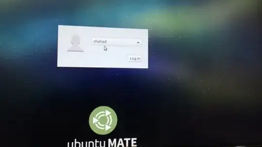

I'm running ubuntu mate on raspberry pi3. when I try to run my pi from my computer by entering its IP to the "remote desktop connection" it won't work unless I connect my pi to a mouse and HDMI cable and hit the "log-in" button that appears on startup.
please how can I remove this log-in on startup??
Log-in
You can do this without editing configuration files: go to System Settings > User accounts, click "Unlock" and enter your password, then click the button next to "Automatic login":
