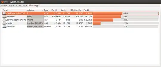

You can look at the File systems tab in System Monitor.
