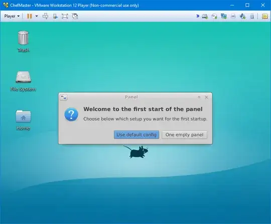

I'm running Ubuntu-Server 16.04.2 LTS in VMware-Workstation-12-Player. I installed
sudo apt install xfce4
and
sudo apt install open-vm-tools open-vm-tools-desktop
when I now start the X-Server by
startx
I see this screen enter image description here
I can see the curser inside the VM (it turns black and a little smaller within the VM) so my mouse gets tracket. But Clicking or Keyboard input doesn't work. I can't even switch back to TTY by CTRL+ALT+F<x>.
Until today I never had a problem with this setup I used multiple times already (Ubuntu + xfce4 + open-vm-tools).
Today VMware Workstation 12 Player was updated to Version 12.5.8 .. maybe it has something to do with that?
How can I get mouse and keyboard to work?

Run:
sudo apt install xserver-xorg-input-all
This installs all the input drivers for X.org.
