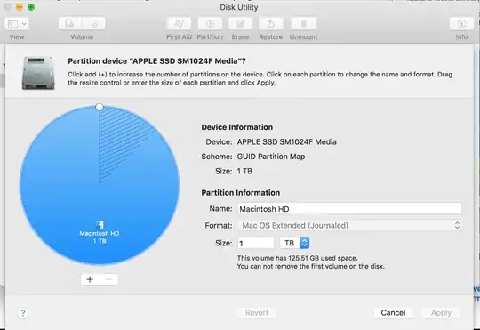

"magic" ended up deleting or modifying my boot sector by apple (without my "actual" permission)
My advice to people just experimenting and beginners like me. WARNING: Its maybe too much work to go through all the details of dual booting.
OSX Disk Utility
Disk Utility
