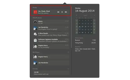

When you're playing a media file, basic controls (pause/next/previous) appear in the calendar & notification tray which can be accessed by clicking on the time indicator at the top bar.
(screenshot source)
You can use the pause button to pause the track currently playing.
