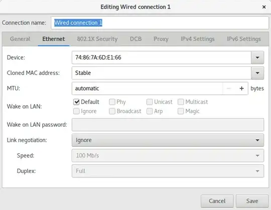

Via GUI
the program nm-connection-manager can also be used to access this setting, bringing up a screen like the one shown below, where the drop-down box for 'Cloned MAC Address' can be changed to one of several settings.

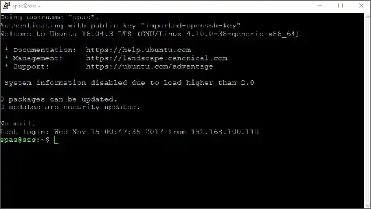

Here is the demonstration of that, how the script works:
