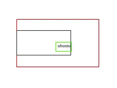

The boot loading screen & the login screen have the wrong resolution.
After I log in the resolution changes to the correct one.
How can I change the resolution during the boot loading screen and the login screen?
