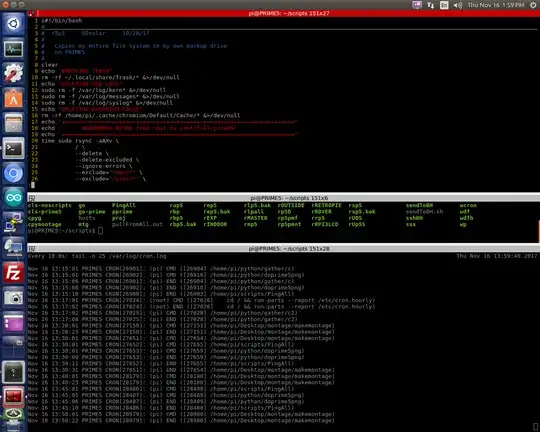

Here is an example of using vim in the top screen.
/home/pi/.vimrc looks like this:
syntax enable
set number
set ts=4
set autoindent
set expandtab
set shiftwidth=4
set cursorline
set showmatch
let python_highlight_all = 1
Regurlarly I monitor my cron activity by opening one window below
(Ctrl+Shift+O)
wcron
to get my real-time cron log monitor running, as per:
16.04: How do I make cron create cron.log and monitor it in real time?
Then in this example I have wcron in the bottom part, and above it I ran a script that went out to the OUTSIDE data-logger to run an rsync back to the hard drive of the mothership.
This is great. Makes the Ubuntu experience much more rich on a single monitor.
