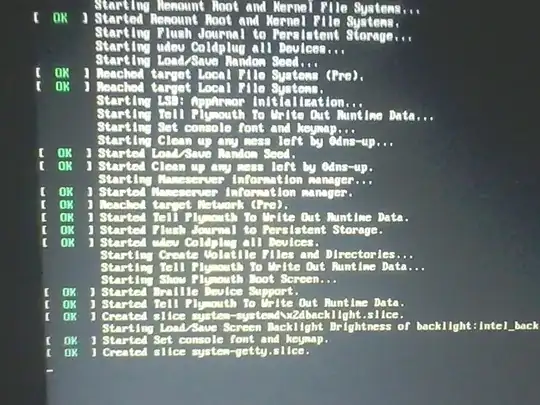

I'm using ubuntu 16.04 and today is blocked he in startup here
hous

From my experience i see this as a kernel error. I had a similar problem in which my system wasn't shutting down just getting as stuck as yours. When starting your system, choose advanced options from the GRUB menu and select a different kernel and it should boot properly.
GRUB menu: Here is the GRUB menu.
And you should see a kernel list here: Select a lower version of kernel (generic) from the menu.
This should start your system properly.
