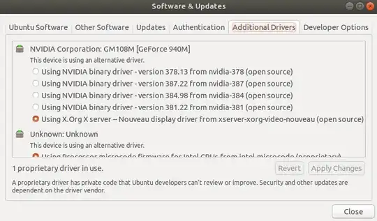

I have found a solution: changing the driver of my graphic card, instead of using NVIDIA binary driver, use the X.Org X server NVIDIA driver

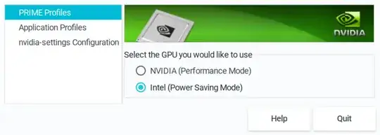

I found that switching to Intel graphics using the Nvidia tool, without uninstalling the Nvidia proprietary drivers, also makes resume from suspend work. (This is option is only available if you have a card that supports Nvidia's Optimus technology).
Also, the error shown on my screen was slightly different; I'm listing it here in case it helps someone with their online search:
[44.436337] NVRM: Xid (PCI:0000:01:00): 32, Channel ID 00000000 intr 80040000
Here is a screenshot of the Nvidia tool with Intel graphics selected:
