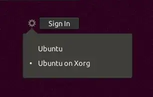

It seems one of your machines is running on wayland as display manager and many applications including x11vnc depend heavily on Xorg/Xserver and fail to work on wayland.
So a switching to Xorg ad display manager should fix your problem. This you can do by logging out and change your display manager by clicking on the small cogwheel beside the sign in button. (See screen-shot)
