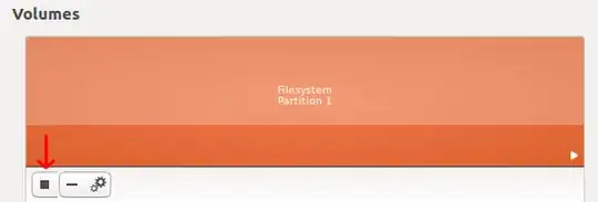

WoeUSB requires that the target device (the USB drive that you inserted) be unmounted before it can write anything to it. Open the Disks application, select the USB device that you inserted in the left pane of Disks and unmount it. Click the black square marked by a red arrow in the below screenshot to unmount the selected partition.
