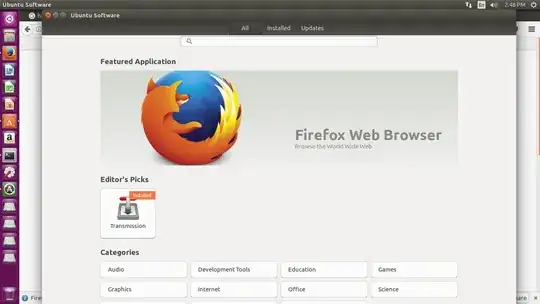

how to get superuser mode to normal mode. When i install my system with ubuntu 16.04.3 it is in superuser mode ican't install new softwares how it overcome i try to install from software center and terminal when i open my software center like this,
enter image description here[1]

You get the output
Could not get lock /var/lib/dpkg/lock ...
when you start a second tool, that wants to do the same or similar things with the installed programs. Both the Software Center and apt-get 'want to do' the same or similar things. The lock is there to keep them from destroying things for each other.
When you close the Software Center, the lock should be removed, and you can run your apt-get command line
sudo apt-get install synaptic
