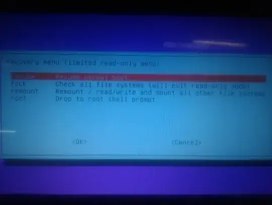

In recovery mode there is no option to boot into failsafe graphics mode (see picture below) Recovery Mode screen
After I pressed Resume Normal Boot the computer appeared to be starting normally but then I got taken to a black screen. shortly after it said Initcll: Event Failed

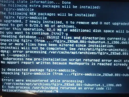

I logged in via tty1 and then tried to install fglrx but was given this error:

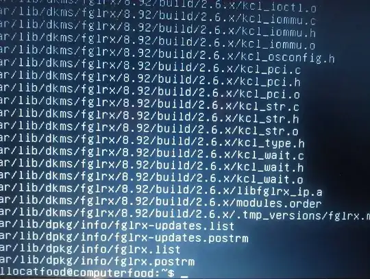

Additionally, I ran locate fglrx and found that traces of the driver have been found in areas on my computer (see below). How can I remove these?
I have tried running aticonfig --uninstall but got the error One or more files have been altered since installation. Uninstall will not be completed. See /etc/ati/fglrx-uninstall.log for details.
Can anyone help me to either uninstall the graphics driver completely or install fglrx again.

With the offline help of Mez I fixed this problem. It seems my problem stemed from where I installed the driver from. I downloaded the driver from the AMD website and installed it manually.
Trying to remove the software using apt-get remove removed fglrx-amdcccle but not fglrx itself. I got the checksum errors when trying to use aticonfig --uninstall because the reinstallation of fglrx-amdcccle didn't match the manual installation of fglrx.
In the end made sure that all other instances of fglrx had been uninstalled and then I ran sudo /usr/share/ati/amd-uninstall.sh --force. I was hesitant about doing this as it warns of system corruption but in my case it all went fine and then I was able to reinstall fglrx from jockey-gtk
