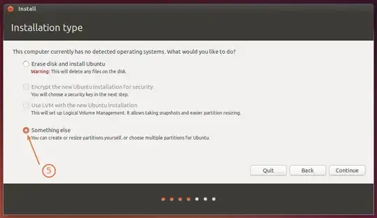

Then, you can run ubuntu live USB and install from there. Make sure to select correct installation type during the installer wizard: Screenshot from installation
One you're in that step, you'll be able to select your old partition as a ubuntu main partition without formatting your windows partition.
During normal ubuntu installation Grub will take care of adding windows partitions back to the boot menu.
