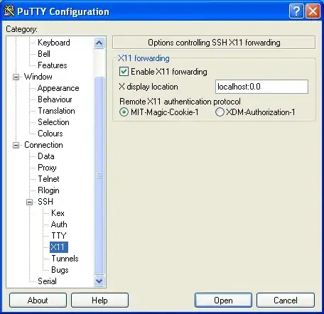

I see PuTTY has the X11 option.
But it throws an error instead of working. It needs an X server on the client side to work with Putty.
Question is in the title: How to use PuTTY to get X11 connections over ssh from Windows to Ubuntu?

Then in your PuTTY session you can turn on the X11: Enable X11 Forwarding
So then save that, and every time that session is invoked you will get a GUI connection to Ubuntu, as long as Xming is running.

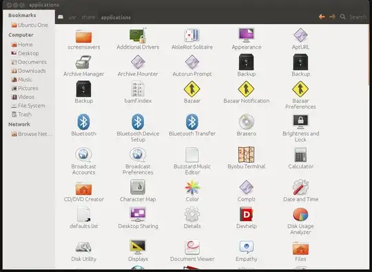

The leafpad editor, gnome-system-monitor, etc., work over the link via the Xming server on Windows.
It is easy to pull up nautilus and browse to
/usr/share/applications
to get any of the installed system commands, as shown here:
Voila, X11 via SSH from Windows to Ubuntu.
