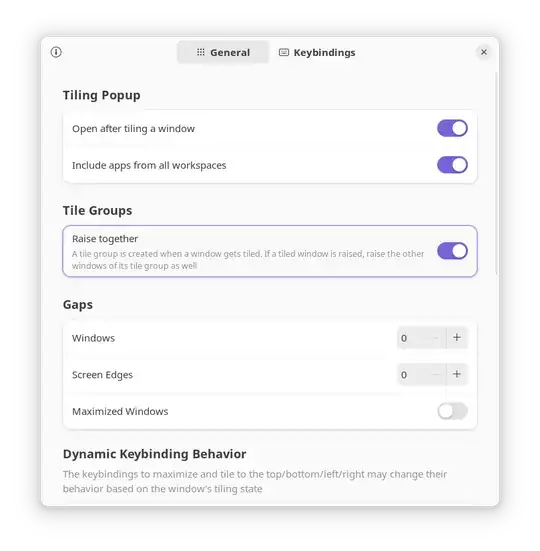

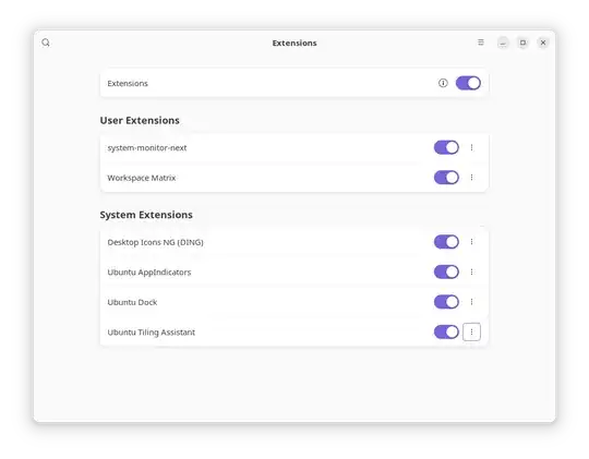

I encountered a similar problem in Ubuntu 24.04 running Gnome 46.
This turned out to be due to a Gnome extension set up by Ubuntu by default: Ubuntu Tiling Assistant.
This can be disabled in the extension's settings by opening Extensions, going to Ubuntu Tiling Assistant settings, then disabling Raise together under Tile Groups.
Or it can be disabled in a terminal by running:
gsettings set org.gnome.shell.extensions.tiling-assistant enable-raise-tile-group false
Screenshots of the settings GUI:
Screenshot of Extensions list Screenshot of settings showing raise together toggle
