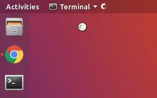

After upgrading to Ubuntu 17.10 from 17.04, I have been unable to launch gnome-terminal.
Upon clicking terminal icon, the taskbar shows terminal loading bar but then disappears after a few seconds.
Terminal loading in the taskbar:
