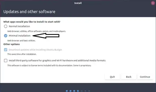

Most Ubuntu flavours at 18.04 now support a "minimal" install option. This would install a browser and a small number of system utilities but most of the apps would be removed.
