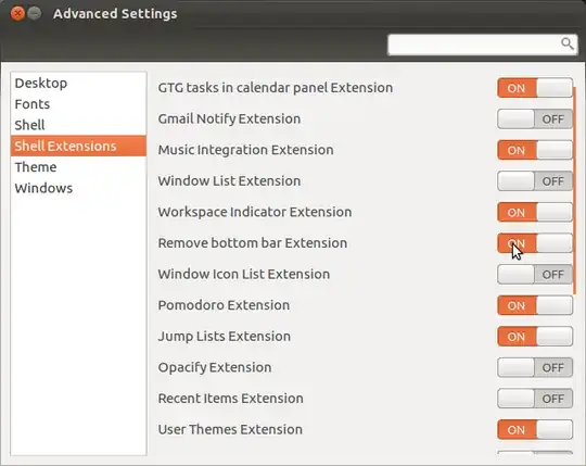

I just managed to hide the messaging tray. Here are the steps I followed:
wget http://aur.archlinux.org/packages/gn/gnome-shell-extension-remove-bottom-bar/gnome-shell-extension-remove-bottom-bar.tar.gz
tar -zxf gnome-shell-extension-remove-bottom-bar.tar.gz
cd gnome-shell-extension-remove-bottom-bar/
mkdir -p .local/share/gnome-shell/extensions/remove_bottom_bar@k2z.com
cp extension.js .local/share/gnome-shell/extensions/remove_bottom_bar@k2z.com/
cp metadata.json .local/share/gnome-shell/extensions/remove_bottom_bar@k2z.com/
Now press Alt + F2 and enter r. After that, open gnome-tweak-tool Install gnome-tweak-tool and turn on the extension 'Remove bottom bar extension'.
