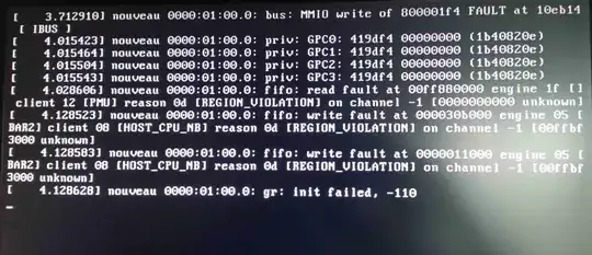

I want to install Ubuntu 16.04.3 LTS from a usb stick but during booting I get the following errors:
Boot Errors
There is something wrong with nouveau. I have GeForce 970 GTX but some time ago I have installed Ubuntu 16.04.1 LTS without problems. How to fix that?

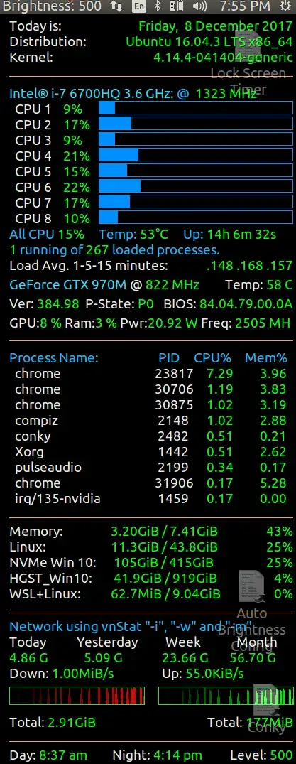

I had no problem booting the Live USB with Nouveau driver but have the GTX 970M laptop chip with 3 GB RAM. The bug in question was for the 4 GB RAM model. FYI after installing 16.04.3 and then configuring Ubuntu with the nVidia driver it works fine on my platform:
Peek Ubuntu 16.04.3
