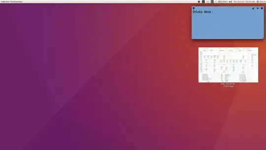

What I want is depicted in the picture below:
In the above picture I placed the image on my Desktop, and resized the image icon to its maximum size, however this does not solve my problem as:
  • I cannot enlarge the image any further as this is the maximum size for resizing icons.
  • When I hover over the icon, the image gets highlighted which happens in case of icons, which I do not want
  • Even with the maximum icon size, the quality of the image becomes really poor as the image is distorted.
I want the image to be easily re-sized and re-positioned without having any of the disadvantages mentioned above.

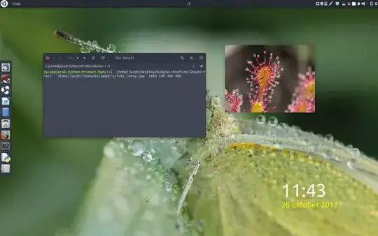

Showing an image on your desktop
Windows can be of different types. We do not only have "normal" windows, but also windows of (in our case) type "DESKTOP".
Windows of type "DESKTOP" stay below everyting; even all items on your desktop show up above them. Therefore showing an image in a window then results into:
...where the sundew image, pinned on the desktop, is actually a window (just like the desktop clock in the image btw).
