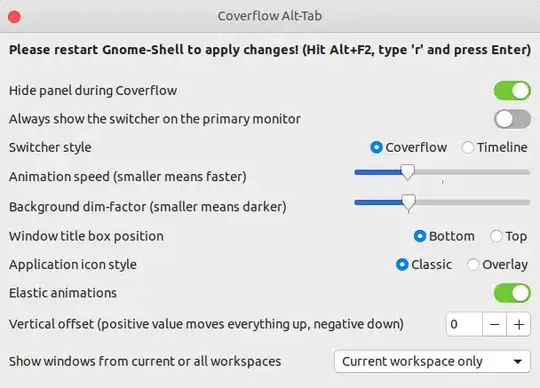

Change your setup:
Settings of **Coverflow Alt-Tab**
