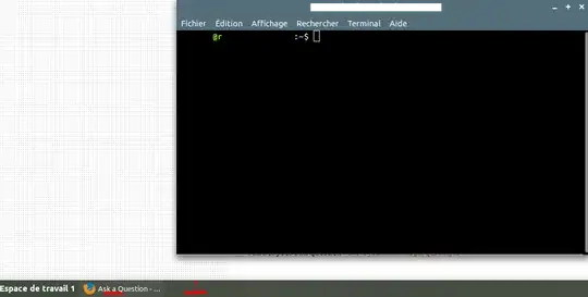

After the recent update to Ubuntu 17.10 and the switch to Gnome, Tint2 still runs but does not show all windows. Specifically, terminal windows do not appear (bot not limited to terminal).
Here is a screenshot, where my current Firefox window is visible but not my terminal.
I've been through all settings of Tint2 without finding any suitable change. The same behavior happens on another computer. If I run a session with Unity instead of Gnome, tint2 works as expected (all windows appear).
Is this a standard behavior ? Is there any known fix ?
I had this problem too, and I went along with it since I couldn't find any solution. I know it has nothing to do but I downloaded TeamViewer and I was having some issues, and it said something about some sessions, and I had to change these settings: in /etc/gdm/custom.conf set WaylandEnable=False
I don't know what does this have to do with it, but it fixed it. Now I can see every window.
Hope it helps.
