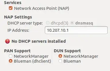

I was looking in this question to give my phone internet from my computer. But then I got this:
No DHCP servers installed
I am really new in ubuntu and I don't know how to fix that.
What do I have to do to install a DHCP server and get internet for my phone?
Theia
  • 113
This is because dnsmasq (DHCP server) is not installed in your system.
To install dnsmasq type the following command:
sudo apt-get install dnsmasq
To configure dnsmasqvisit this link: Dnsmasq
