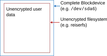

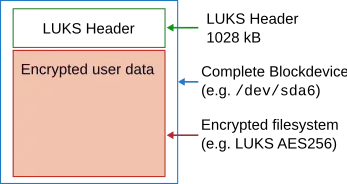

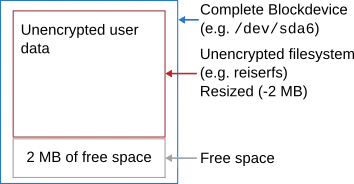

LUKS in-place encryption exists. But you need to set up your environment a little as per the pictures:
(Also see this question)
