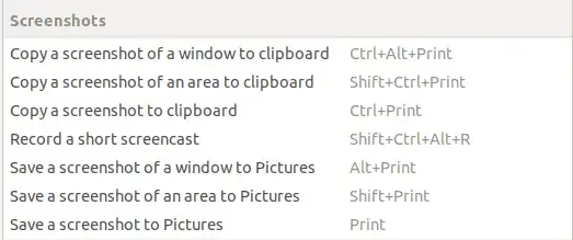

You can check it out from Settings:
Device > keyboard > keyboard shortcuts > screenshots
You can copy it to clipboard without saving using Ctrl+Alt+PrtScr
Screenshot shortcuts from settings
