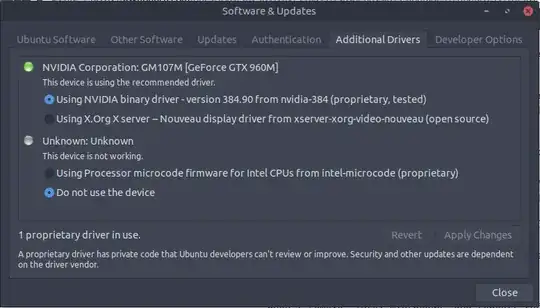

I don't understand why (found here), but I can resolve the issue by uninstalling the intel-microcode package with apt (or you can go to the "Software & Updates" application, navigate to the "Additional Drivers" tab, and select "Do not use this device"):
Software & Updates
When I remove intel-microcode and reboot, the problem seems to go away, and I can suspend like normal.
EDIT: BTW I am on the most recent BIOS version 1.6.1.
EDIT2: From some recent updates (I believe) it seems as though selecting "Do not use the device" is no longer an option for microcode. I am now on BIOS 1.6.1 (after Dell cancelled 1.6.1 and then re released it later), and the suspend issue seems to still be around... :(
